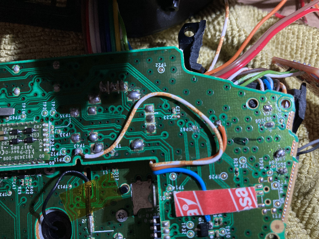

« Reply #702 on: May 04, 2023, 04:45:06 PM »
Hello again, I just shot another pad, in this case TP67 and now it does affect the operation of RT (it stays pressed). Is there any way to fix it?
Thanks in advance.
  • Posts: 2673
Re: XB1 Controller PCB Scans, Traces and Info - 1708 "Slim"
« Reply #703 on: May 05, 2023, 04:31:37 PM »
Stop using that kind of wire for starters. Get yourself some 30awg Kynar wire or Wrapping wire.
That TP67 is right in the middle of the trace run, so you've just opened it up is all. You'll need to solder a jumper wire from the bottom of C36/R39 to the Via that is just below the T in TP67.
Offline Ixnay
« Reply #704 on: May 05, 2023, 05:54:59 PM »
Hello RDC, Thank you very much for helping me and for your advice, the truth is that I am a true noob with electronics although learning and experimenting new things entertains me a lot. This world has always caught my attention and for that there is a lot of interesting information in this forum. I'll get the cable you recommended before continuing to liquidate pads 😅. I already imagined that the solution started from C36/R39, I already used that point to read value with an adc module, which I didn't know where to bridge to.
Again thank you very much for your help.
