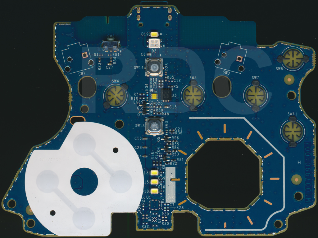

1797 BUTTON BOARD TOP
1797 BUTTON BOARD BOTTOM

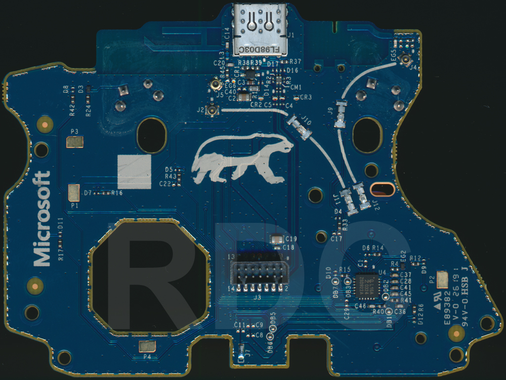

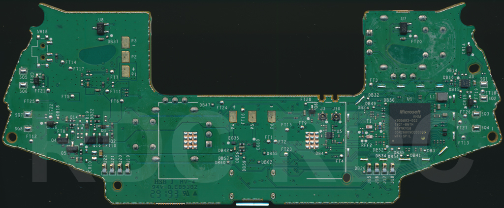

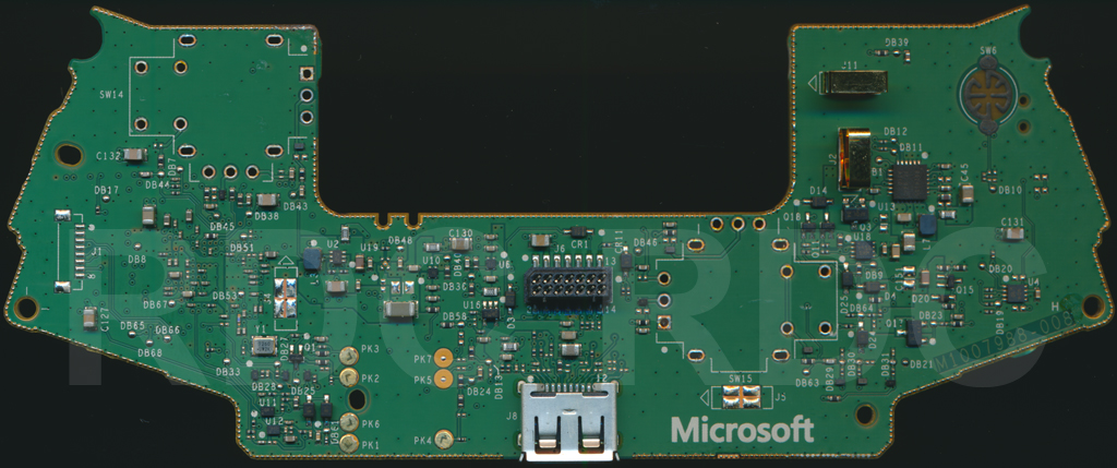

1797 MCU/POWER BOARD TOP
1797 MCU/POWER BOARD BOTTOM
J3/J6 Connector Pinout

My Schematic* of the Button Board - https://www.acidmods.com/RDC/XB1/Schematics/XB1%201797%20TOP%20BOARD.pdf
* Information will be updated when/if I get them scoped and/or figured out.
The Power regulation has all been moved to the bottom MCU board now and is mostly done with a BQ24250, which is the chip that was in the older version PnC packs. - https://www.acidmods.com/forum/index.php/topic,43204.0.html

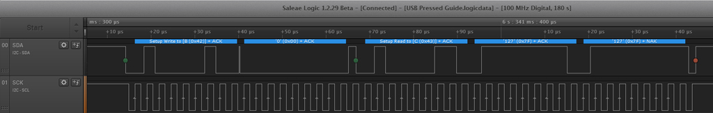

The Guide button LED has the standard White LED, but also an RGB just under it now. They are all controlled with a PCA9632TK over the I2C, so just about any combination of color and brightness is possible with that layout for the Guide button color now, but that will need to be done for most thru whatever app they provide.
The buttons are still done using the PCAL6416A IO Expander like the 1708, but the button order has been moved around. The Mode button has been added (MD) and the PnC detection has been removed, as that is all handled differently now. NU (DB3 reads Lo), DR, VW, SY, LB, DU, DL, DD, NU (P17 reads Lo), A, Y, RB, X, MN, MD, NU (DB7 reads Hi)
This is with no buttons pressed, so you'd get 01111111 then 01111111 after the Read Command, or 0x7F then 0x7F

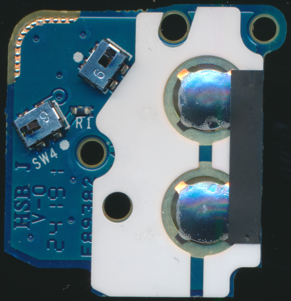

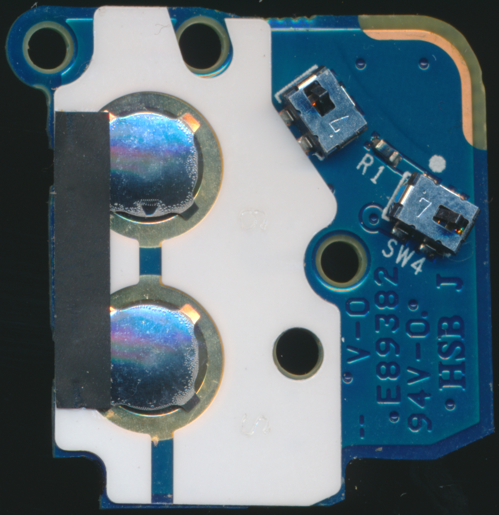

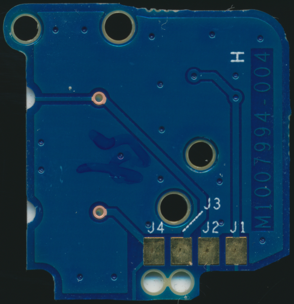

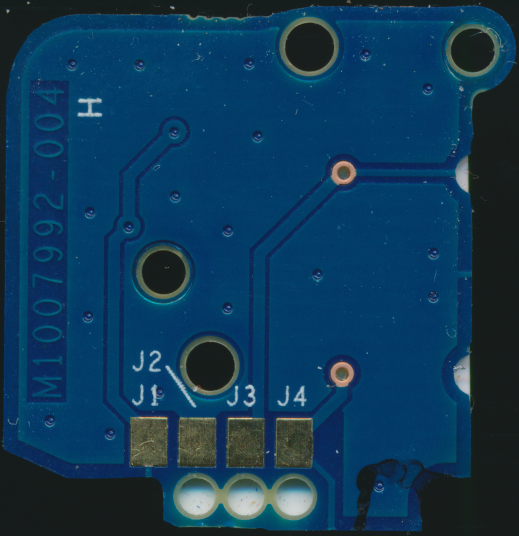

The 4 alternate buttons now used 2 boards, versus the 1 board the 1698 controller used, and there are also 2 switches per board that are used to let the MCU know where the Trigger Stop selection is at.
RT, P1, P2 BOARD TOP
RT, P1, P2 BOARD BOTTOM
LT, P3, P4 BOARD TOP
LT, P3, P4 BOARD BOTTOM

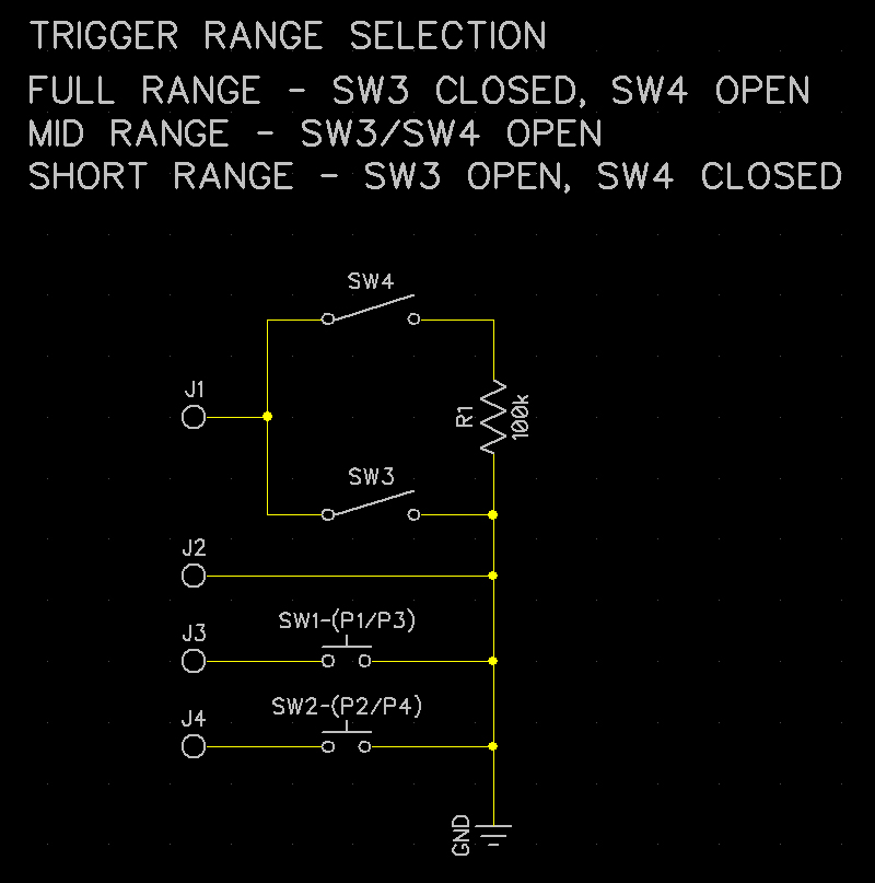

LT/RT BOARD SCHEMATIC
I'm sure this was done to keep the thing in check for those mid and short pull settings as the voltage Output of the Hall Sensor doesn't drop near as much as a full pull, so the MCU needs some way to be able to tell those mid and short pulls aren't actual mid and short pulls of the full range and that they need to be treated differently.
~1.43v NOT PULLED
~0.57v FULL PULL
~1.10v MID PULL
~1.31v SHORT PULL

Hey there,
i bought an used elite 2 controller and replaced the analog joysticks and the rb and lb buttons. After assembly i recognized the LT button only works on full range and mid range. The short range is not funcitonal. I saw a capacitor or resistor (i dont know) is broken away. Do anybody know which piece it is and what is the value:
  • Posts: 2673
Re: XB1 Controller PCB Scans, Traces and Info - 1797 "Elite Series 2"
« Reply #16 on: February 22, 2021, 04:37:27 PM »
That missing Cap isn't causing the LT issue. As long as the trace and pads are still intact it'll be fine with that missing.
Look on the LT switch board first, make sure the Resistor is on there and that SW4 is not damaged. Then make sure all 4 of the contacts for it are good on it and the motherboard.
« Last Edit: February 22, 2021, 04:44:19 PM by RDC »
Offline alex_steward
« Reply #17 on: February 23, 2021, 01:41:51 AM »
Thanks for reply.
I measured the trace and pad and there is a passage, so it is ok i think. Then i checked the LT board and the resistor is there. I measured it and the value is 100.2Kohm. The SW4 is not damaged. I measured all 4 pins and on 2 pins there is the whole time passage. On the other 2 pins there is only passage if SW4 is pushed. Finally i stretched the 4 pins of the button board that touches the 4 pads of the LT board. But after assemble it still not works on short range. I pushed with my fingers the parts harder together so there must be a contact from 4 pins to 4 pads. But no success. Do you have any ideas?
##Edit
i reassembled a second controller and checked the LT board there and the LT board works fine. Now i know it must be a problem with the 1797 MCU/POWER BOARD. Can it also be a mechanic problem, so the LT button is not sink enough? Maybe it isnt the problem but i can see the LT button is not sinking far enough as the RT button on short range. It is a tiny range, but i am wondering how it could be so and could it be the fault.
« Last Edit: February 23, 2021, 02:56:40 AM by alex_steward »

Could TP DB28 be helpful to identify if the voltage is correct for the different ranges?
  • Posts: 2673
« Reply #22 on: February 23, 2021, 05:30:35 AM »
It will tell you if the switches and all on the LT board are working correctly. How they are doing the actual measurement is all done inside the MCU though.

Hey Guys,
I did a repair on the left stick, fully replacing the component. For some reason, after the repair, both sticks are reading a full tilt 1.00, 1.00 on Left and -1.00, -1.00 on Right. Also both triggers are not responding now. CR14 doesn't seem to be on my MCU when compared to your board above. Curious if this is the cause or if I should test something else. I don't see any obvious integrity loss to components or passage disruption. I was very careful to replace the component without damaging anything, but i guess you never know with all the smaller components lying around.
Thanks,
Matvey
  • Posts: 2673
« Reply #28 on: October 05, 2021, 07:32:00 PM »
What does work on that thing? The voltage for the Sticks and the voltage for the Triggers both come from different Regulators, U10 and U6 respectively, but they both get their voltage from the 3.3v rail. If that had an issue nothing on there would work enough for it to even connect to anything. The MCU controls both of those Regulators, but if U10 is off and the Sticks are getting no power, then they should both be defaulting in the same direction, not one going one way and one going the other, that's odd as frig and technically impossible.
CR14 missing isn't going to effect any of those functions, but it should be on the board, especially if CR13, 15 and 16 are still on there.
If that thing was potentially knocked off, I'd start looking for other things that might also be missing or don't look right on there.
Could be the MCU would up all corrupt as a politician somehow, and is the only thing I could think of right off tata would make all of the Analog functions behave like that.
Offline Dockie
« Reply #29 on: November 19, 2021, 12:44:30 PM »
Hey RDC, great work as always, your scans and schematics have helped me no end.
do you have any idea what these two components are i've circled? one is on RSC and one is on the output of RSY.
