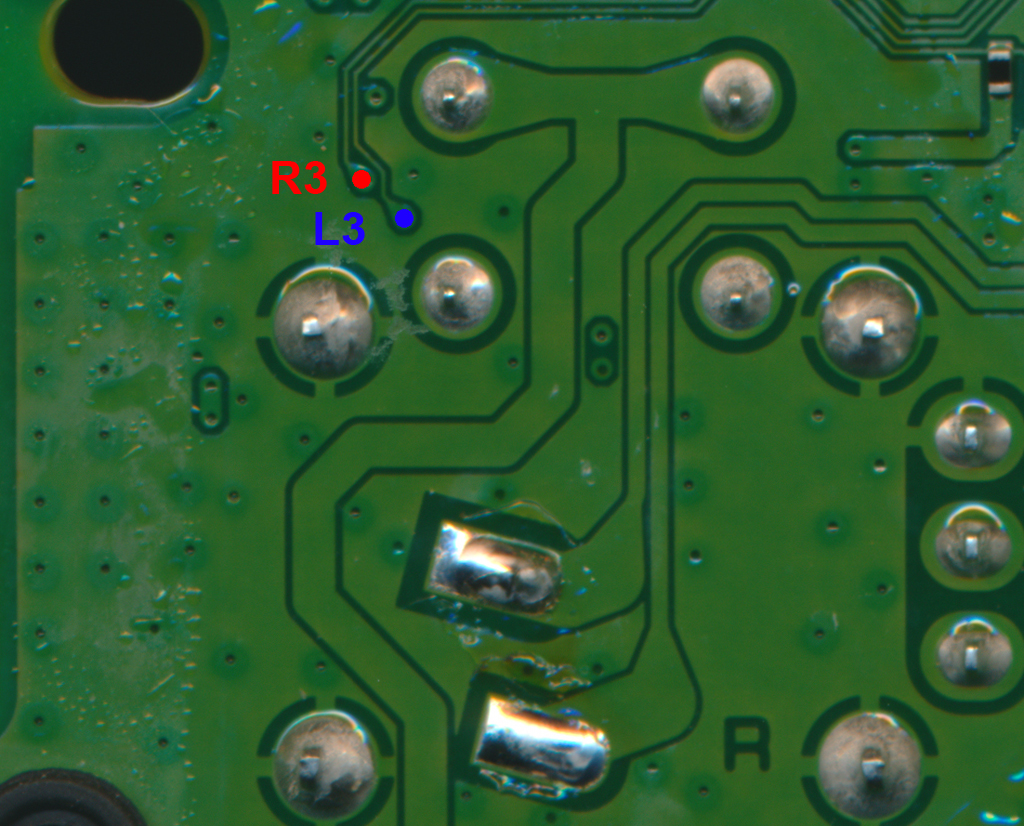

  • Posts: 2671
Re: DualSense 5 Controller PCB Scans
« Reply #201 on: November 06, 2023, 12:15:46 PM »
The only easy spot you get is the pad that's there on that trace. The one at the top right corner of your red square.

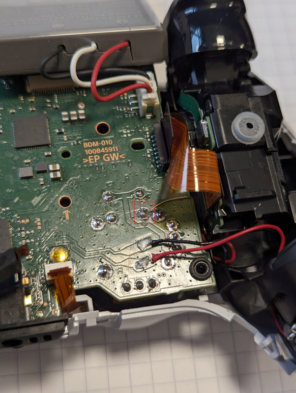

Offline Torgar
« Reply #202 on: November 08, 2023, 02:26:18 AM »
Hello. Thanks for those scan RDC.
I'm actually in the same situation as setdeath described above: I may damage the L3 vias while replacing the left joystick.
I soldered a wire between the hole's button on the bottom to the 0201 pad you mentioned.
I'm reading 1.8V when L3 is push and 0V when L3 is released (so same behavior as R3) but L3 is still not detected (I'm using the Steam Controller tester).
Any ideas where this track is going on the board ? I may have damage something else.
Thanks
« Last Edit: November 08, 2023, 02:28:11 AM by Torgar »
  • Posts: 2671
« Reply #203 on: November 09, 2023, 12:57:41 AM »
Over 2/3 of that trace is on an internal layer.
Last spot to get at the L3 before it goes under the MCU is this via here.

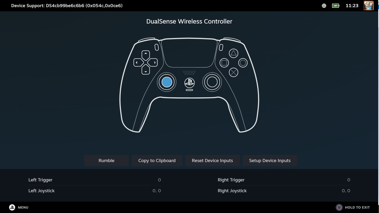

Offline Torgar
« Reply #204 on: November 09, 2023, 02:25:56 AM »
I confirmed those two vias.
I'm reading the correct values on those two points (1.8V when you push L3/R3).
I've made a factory reset (through the push button on the bottom of the PCB) but nothing changed.
Then when I "Reset Device Inputs" (I didn't do it last time) on the Steam Controller Tester, now L3 is recognized !
So I guess it was just a software issue. I will test it on the PS5 later but I'm pretty confident about it.
Thanks for the help !
Edit: Working as well on the PS5
« Last Edit: November 09, 2023, 09:40:03 AM by Torgar »
