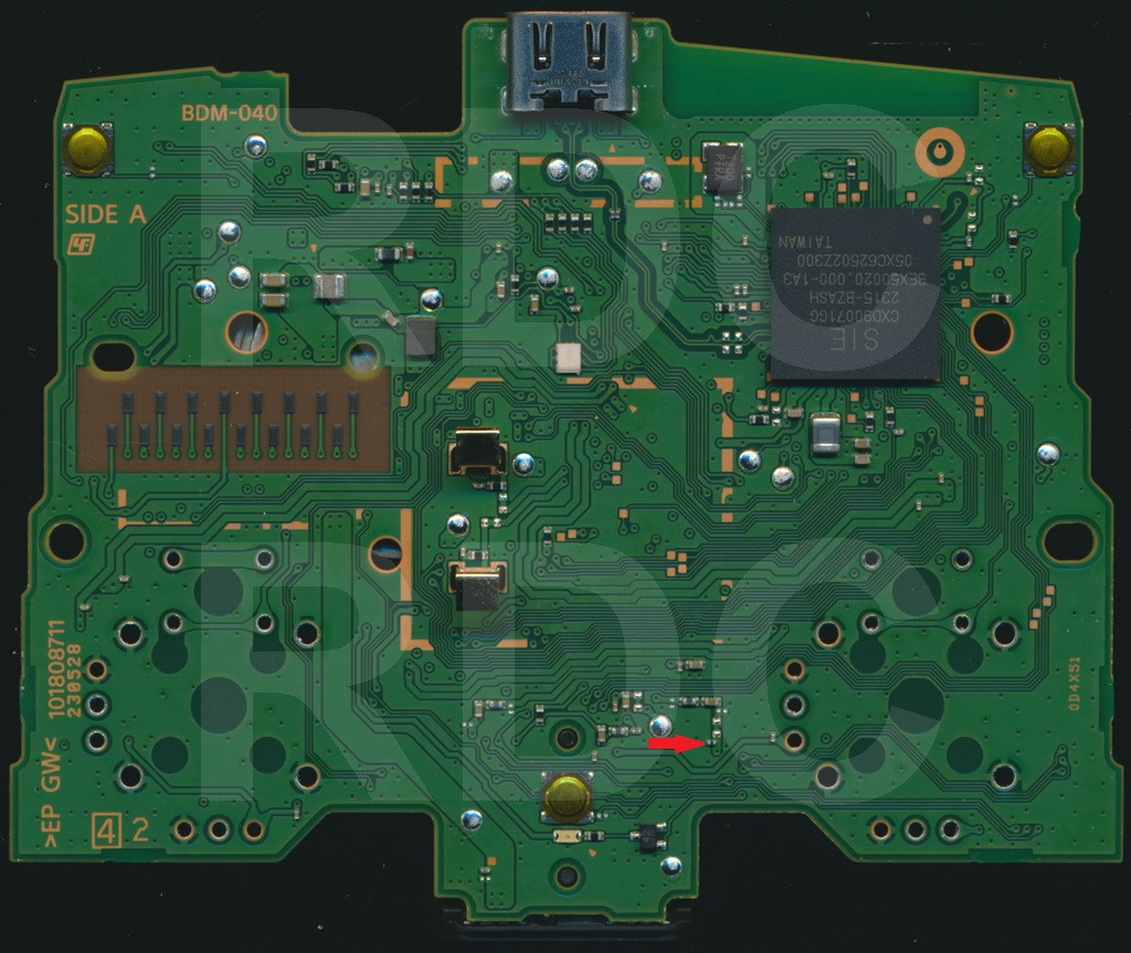

« Reply #370 on: April 26, 2025, 09:41:17 AM »
Hi. BDM-040 board, I lost this smd resistor when replacing the analogue joystick, the controller isn't recognised, flashes 3 orange lights and then turns off. What's the value?
  • Posts: 2670
Re: DualSense 5 Controller PCB Scans
« Reply #371 on: April 27, 2025, 04:32:51 PM »
7.5k

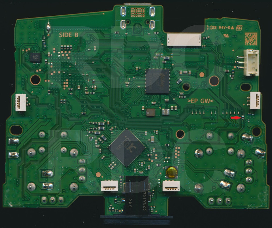

Offline BuddsControllers
« Reply #373 on: May 18, 2025, 02:03:47 AM »
Hi,
I recently purchased some unassembled edge PCBs and thought I would share. I haven't posted a pic here before so don't know how to, I was clicking the button and it just writes ........ anyhow enjoy, I have the trigger boards, module and main board front and back.  :yess:

Hello guys. Need help. I have a BDM-040 board where I am missing smd? does anyone know what its value is? Thanks.
« Last Edit: May 23, 2025, 12:42:41 PM by Knoxville78 »

« Reply #375 on: June 12, 2025, 06:50:27 AM »
Hi, I've lost these two components. What are their values?
  • Posts: 2670
« Reply #376 on: June 12, 2025, 09:41:44 AM »
Resistor is 5.1k
Cap value isn't really critical.

Offline KeptWolf769
  • Posts: 18
« Reply #385 on: December 05, 2025, 06:32:00 PM »
I just replaced my BDM-040 joysticks with Hall effect joysticks. Everything worked perfectly for a while after being reassembled. It went off just when I was done testing and preparing to calibrate, and has been unresponsive since. I have tried different batteries, but still no response. This is my second time working with a DualSense, and I am a YouTube learner with no formal training in electronics. Can anyone help me out? I swear I can follow instructions. I'm very desperate. :beg: :beg:
https://1drv.ms/i/c/35b35d5021895f51/EfIDKkFjQpVHrVxMpdFp1NABqR6wXCATQRBMvgtAn3fN6g?e=WY0wTC
Just realised that 3 of the resistors under the SIDE B label came off, any solutions? links to buy replacements or alterations that can be made.
https://1drv.ms/i/c/35b35d5021895f51/EUye6RK11-xAjgOhWdHRfKEBT7_hY7J5ghqWnE6DVD0a9A?e=MpFrKT
« Last Edit: December 08, 2025, 08:11:43 AM by RDC »
  • Posts: 2670
« Reply #386 on: December 08, 2025, 07:06:10 AM »
@woyeshizuileye - Those Capacitors are just for decoupling on voltage rails. The exact values are not critical.
@KeptWolf769 - Those Resistors are 4.7k, 0402 size. You can get them at places like Digikey, Mouser and the like online.

Hi!
I lost this small component from the top of the BDM-040. What is it and what is its value?
« Last Edit: December 10, 2025, 07:06:35 AM by Worf »
  • Posts: 2670
« Reply #388 on: December 10, 2025, 07:46:20 AM »
Haven't traced that circuit out, but looks like it's on one of the mic inputs. Measures as 100pF here, 0201 size, but I doubt it's a Capacitor as the thing is black. Haven't seen any caps yet that weren't tan, brown or gray, so I'd guess it's probably some kind of TVS diode.
