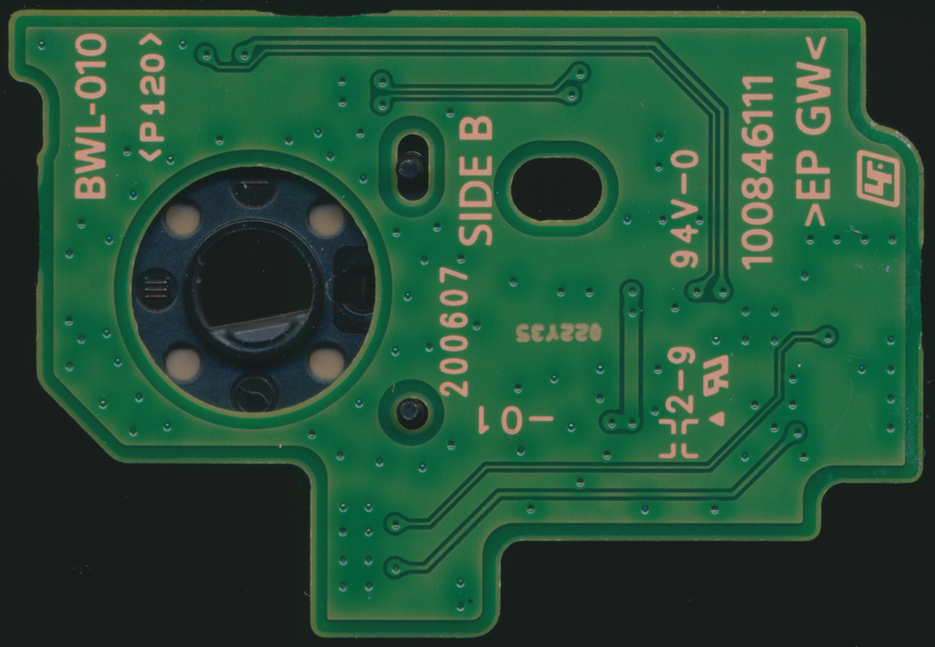

BWL-010, TRIGGER ASSEMBLY TOP
BWL-010, TRIGGER ASSEMBLY BOTTOM
BWL-010 FFC PINOUT - CAUTION: This is the pinout of the FFC connector on the BWL-010 board above, it is NOT the pinout of the FFC connector on the motherboard. See above for those.
1 - 1.8v
2 - L2/R2 Feedback
3 - GND
4 - L2/R2
5 - GND
6 - 1.8v
7 - GND
8 - L1/R1
9 - SDA1
10 - SCL1
11 - WP1
12 - 1.8vE
13 - GND
14 - M-
15 - M+
16 - GND

The L1/L2 and R1/R2 Trigger assemblies are pretty much identical, from a hardware standpoint, but the TP spots have been moved around on this version.
NOTE: If duplicating the L2/R2 consider doing that thru a 1k Resistor versus driving the L2/R2 line directly to ground.
BWL-020, TRIGGER ASSEMBLY TOP
BWL-020, TRIGGER ASSEMBLY BOTTOM

The Trigger assemblies are not as complex anymore. The PCB just has the Feedback POT on it, with the motor being wired directly to the motherboard like the Rumble motors are.
The FPC is also changed and now has the L1, L2, R1 and R2 buttons incorporated into it, bringing it back inline with how the DS4, DS3 and even the DS2 were made.

Are there any power rail test points I can tap into to use as an enable? Something that's only on when the controller turns on?
EDIT: I metered my entire led circuit i plan to drive, controller included, and it peaked to about 160ma. Is there any 3.3-4.2v rail that is only powered when the controller is on, that would be safe to just wire the thing in directly? OR is wiring it to the battery still recommended?
« Last Edit: February 04, 2021, 12:49:02 AM by MCorgano »
  • Posts: 2670
Re: DualSense 5 Controller PCB SCans
« Reply #22 on: February 04, 2021, 08:19:11 AM »
Unplugging the small FPC wrecks the voltage divider that makes up the L2/R2 since they are Analog. I can only guess they do not have direct access to the Feedback signal and are just using the L2/R2 position for now to show where that is. Wire up a Tact straight across the L2 or R2 contacts, press it, and see if the Feedback signal goes to 100%. If it does, then that's not the actual Feedback signal as the Tact will not move that Feedback POT at all.
The remote has on/off buttons. Use the AN+ of the Sticks for an Enable signal. It's a switched 1.8v source that will be good enough for turning on/off an N channel FET.
I have no way of knowing what a safe current to pull from any of the spots in there would be as I didn't design it or have access to the DataSheet for the PMIC in there.

Through some experimenting I can tell it's definitely using the pot position to close the loop for the stepper position. I think now that it was the software side doing it - it was scaling the FFB position to how hard the trigger was pressed. That would explain the lack of direct electrical connection affecting the position and why the position changes when you unplug the cable - because the position of the trigger does.

Oh ok, I also heard somewhere there was a new revision of ps5 controller labeled BDM-020. Anything notably different on the new version?
  • Posts: 2670
« Reply #27 on: December 08, 2021, 06:48:13 AM »
Haven't had one to really dig into yet, but they put the MCU on the other side of the board.

Hello Guys,
i'm sitting in a wheelchair and want to build me a adaptive controller, like the XBOX adaptive controller.
But i can't find any informations about the solder points for the create and options buttons on the pcb.
Do you know where are these solder points? Are there also solder points for the touchpad button
on the main pcb. I hope you can help me. :#1:
Best regards
synrg
  • Posts: 2670
« Reply #29 on: December 28, 2021, 07:12:36 AM »
There aren't any nice easy to hit solder points for the Create and Option buttons, unless you were to remove them, then you could use the existing solder pads for the buttons. The TP button is on the TP board, and there is a spot to solder to for it, if it's take apart first. The first post has been update with the vias for all of those buttons. Do take care when soldering to those vias, as you pretty much get just one shot at them before it becomes much more difficult to get to the next usable spots.
