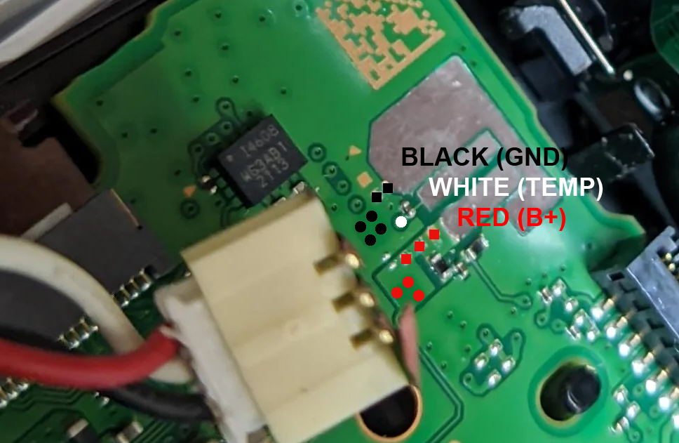

I have accidently ripped off the battery connector on the pcb and I cannot find the tracers anywhere online to jump the wires.
Can someone please tell me where the battery connector tracers are? Would really appreciate it!
It's similar to this reddit user:
« Last Edit: July 04, 2023, 03:51:33 AM by kawa90 »
  • Posts: 2670
Re: DualSense 5 Controller PCB Scans
« Reply #136 on: July 04, 2023, 04:07:10 AM »
Offline kawa90
« Reply #137 on: July 04, 2023, 08:01:56 AM »
Thank you very much @RDC
Much appreciated it!
