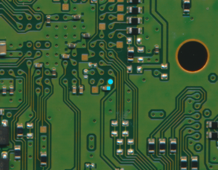

Hello guys! My first post here. Thanks for everything, this is just wonderful.
I managed to destroy both sides of `X` via (BDM-010). Is there an alternative soldering spot?
EDIT: It was tricky but the via is still functional. But the question still holds - are there any alternative spots?
« Last Edit: July 12, 2023, 07:02:59 AM by VectorOfInt »
  • Posts: 2670
Re: DualSense 5 Controller PCB Scans
« Reply #155 on: July 12, 2023, 09:31:44 AM »
Last chance for X.

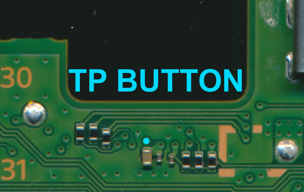

Thank you! Where is the most accessible spot to solder the TP button on the 030?
Also is there a key for where each of those 16 pads connects to? I was assuming just the reverse order of the image on page 2 at first, but there are only 13 labeled on that one so I'm guessing there are some differences.
« Last Edit: August 23, 2023, 03:08:01 AM by Manavie »
  • Posts: 2670
« Reply #177 on: August 24, 2023, 04:26:31 PM »
I have not traced all of the -030 or it's Touchpad out, but if it's held the same pinout as before, then it's in roughly the same place as the -010 on a via all by it's lonesome.
