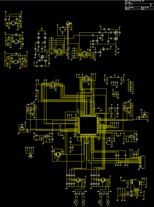

Hello, i'm hacking a xone pad to put it on an arcade stick. is it possible to make it flat without using the top board ? PCB can be powered via the J5 connector and each button too on J5 and J6.
i tried to connect J5 D+ D- (with 33ohm resistor) 5V and ground unsuccessfully to a usb port. does another pin needs to be connected ? maybe DETECT USB on J6 pin 7 ? if yes, it has to be grounded or powered ? i already read the whole thread on srk, nobody wants to hackpad it like this... using the top board is sure easier, but i want it clean.
thank you.
  • Posts: 2640
Re: XB1 Controller PCB Scans, Traces and Info
« Reply #36 on: December 18, 2014, 12:03:08 PM »
Can it be done? Yes. Should it be done? Not really, as it's just more of a pain than using the board that already has everything you need right there. It's an arcade stick, you have plenty of room to work with.
If you're wanting to go that route though, give this a try and see what happens...
J5 connections
1 - 3.5v (only needed if Rumble will be used)
2 - DR
3 - DU
4 - DD
5 - DL
6 - SY
7 - IR LEDs (use a NPN Transistors, do not drive LED directly from this pin)
8 - USB 5v
9 - LB
10 - USB D+ (33ohm)
11 - Not needed
12 - USB D- (33ohm)
13 - Ground
14 - USB Ground
J6 connections
1 - 3v  (yes it's needed, the controller doesn't run on USB 5v alone, that top board has all of that crap on there for a reason)
2 - LED (use an NPN Transistor, do not drive LED directly from this pin)
3 - Ground
4 - 3.3v (yes it's also needed)
5 - RB (may need a 1N4148 across RB connections, Anode to Ground, Cathode to RB)
6 - GU
7 - Not needed
8 - A
9 - X
10 - Y
11 - MN
12 - VW
13 - PNC Detection (connect to Ground thru 25k or so)
14 - Ground

Really hoping someone can help me.
My problem is that my B button is no longer working after remapping it, I also remapped A and it works great but B doesn't work on the controller pr the tact switch. I think my first mistake was soldering my contact from the tact to both connections at d14, and then I went to desolder them and lifted the pad on the top pin of d14, I haven't really attempted to repair it because I don't wanna screw it up anymore, but I may have because I scraped the carbon off the left side of the B contact pad and soldered my contact here to the tact still not working on the controller or the tact I can provide pictures if that helps. Thanks in advance!
  • Posts: 2640
« Reply #49 on: February 01, 2015, 11:07:09 PM »
Soldering to both spots at D14 would cause the B button to be pressed all of the time.
Ripping up the top pad of D14 is the problem now, as that has opened the B button trace, so soldering the new Tact to the B button contact would do nothing.
You need to solder a jumper wire form the left side of the B button contact, provided that it's not already ruined, to the first B button via now. If you ruin the Via on the top then you have 2 more on the top to attempt to get that right, if you ruin all of those then you'll have to connect it to the one on the bottom, if you ruin that you'll have to connect it to the lead on the MCU, if you ruin that then you're done. The entire B button line is traced out in the pics on the first page.
« Last Edit: February 01, 2015, 11:10:11 PM by RDC »
Okay so the via next to the top of d14?
  • Posts: 2640
« Reply #52 on: February 02, 2015, 07:44:59 AM »
Top/right, but yes, closest one above it.

« Reply #58 on: February 02, 2015, 04:30:53 PM »
Back up 1/4" and take the pic again, the part that really needs to be seen is blurry, either way it's not ruined, I could fix it.
Offline Psychnah
  • Posts: 8
  • N00b
« Reply #59 on: February 02, 2015, 05:04:09 PM »
Is this one better?
