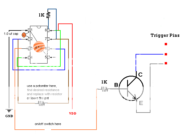

hi...i have all the stuff for the rapid fire its just i dont know what lead is what on the npn transistor (case info TO92h) it would be great if someone knew thanks

THIS IS FOR ADJUSTABLE 555 RAPID FIRE ON MOMENTARY SWITCH
I altered your schematic..
Duel Momentary Switches, with toggle on/off: and Trimmer Potentiometer.
Tested And Working.
I made this design since I had the Momentary switches installed already so I wanted to keep them, The toggle on\off is obliviously for the mod to turn on\off, and the Trimmer.. I love it the ability to change the rate of fire, amazing.

ill test that haloed got a friend of mine who plays halo alot wants it duel ill try this for him :D

Post Your Results If You Do.
but you may want to put the resistor back in at the trigger points, not absolutly nesecary, but it should be there

i was just wondering if you could run a led so you no when its on cause tomorrow im going to get the parts for and i was thinking it would be cool to have a led to see if it on so if you can email me please CAMKILLERS@gmail.com please and thank you

cam killers, please take the time to read, or even skim through the thread, as this has been done, and there is more than one diagram showing how this can be acomplished.

If i wanted to use a resistor instead of the pot which would be faster a smaller one or bigger.

setthe pot, and test the resistance.

im trying to make it non adjustable
but i guess ill just go buy a bunch of resistors and find out
You don't have a multimeter or Ohmmeter? If not I recommend investing in one to find the proper resistance.
Because If you just put a random resistor it can potentially ruin your controller(Triggers).

good point, but it should not hurt the controller, just the 555 chip itself, as the triggers are protected from the 1K off pin three, with the pot or resistor, you are changing the way the chip oscolates. but yea haloed has a good point.

Very good tut easy to follow and explains enough for the general public like me.  For some reason though my rapid fire stutters sometimes like in the middle of a clip it will pause or "break" for not even a second and then continue but it is a lil annoying if anyone has a clue what it could be plz message or post back.  The only thing I could recommend for this is posting different places to place the chip in the controller where it can fit and where people have put it if you have to cut the inside a lil bit or w/e.  I put my chip in the lil spot on the top part of the controller underneath the left joystick next to the D-Pad and above the left rumble there is a lil pocket.  I'm also wondering if using smaller gauge wire is ok because the 30 gauge seemed a lil too delicate for me and kept breaking at the solder joints.  TTYL everyone.

i got a few question first off
haloed whats the left trigger for?
second modded matt where your trigger supposed to go? or do you use the current trigger with this mod?
oh yeah one more thing modded matt do you think it would be a good idea to drill a hole for the potomitor to adjust it for different games? sorry if you guys already done this and im a little behind please dont chew me up

my origional design (as you posted it above)  uses the 360 controllers trigger to fire rapidly. the on/off switch turns rapid fire on/off this is a building block that people have tweeked to fit thier needs.
in the modified schematic by haloed, he has rapid fire on an extra button, and added the left trigger.
I personally would mount the pot through the controller. so it can be adjusted for other games.
I have the install tut finished, but my photobucket is on the verge of locking for the month due to bandwidth restrictions (the high res pics I took for the xclamp fix and 360 tear down tuts ate it up.)

I dont have a scope to measure the squarewave but I would guess somewhere from 2-50
i know I'm new here but id thought i throw my 2 cents in.  if you do the math it should be adjustable from 7 herts to 1440 hertz. hertz=pulses per second. the .1uf resistor between 1 and 5 will change the fire rate a little but not much
I would use a 47k ohm in between 7 and 8 instead of the 1k it would change the rate to 5-30 instead of the 7-1440 it would also square the pulse wave better for more consistent operation
also be careful adjusting it too fast because you are only adjusting the off time.

hey modded matt do i really need to use the pcb board from radio shack and what type of wire should i use 30 gague or 22 gague?

you dont have to use that board, any will do, or if your good you can free form it. wire dont matter, make sure all the other parts are exact though

Just finished this mod! didnt order the exact parts, but i found close enough parts off farnell as im from UK. mod works fine! i still havent assemled the controller because tomorow im adding a led and drilling a hole to alter the pot.
if anyone needs help, just post, im new to modding and this was a breeze! peace

is this verified to work on modern warfare 2? i got it up and running on split screen but then when i tried it online, live capped it. if so, is there a set resistor i could use in place of the pot? thanks

I was not aware of a cap at all in MW2??? set the pot where you want it and measure the resistance between the two pins, then replace pot with resistor
