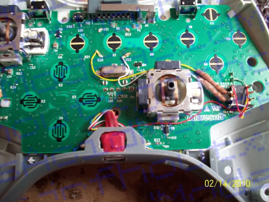

« Reply #174 on: November 09, 2010, 09:56:11 PM »
ok, look, in your diagram (on page 1) you show the chip face up (aka 'crawling'), which I assume is to clarify pin orientation and which wires go to which pin. in order to solder everything together initially I place the chip in that orientation so as not to confuse myself when soldering to the chip.
upon installation i suppose you really could install the chip either way, but personally I install it face down (aka 'dead bug') to prevent the pins from scratching the solder mask off the board and potentially causing a short and so that it doesn't stand off the board, the damn things already only barely fit inside at the recommended install location...
here is a pic of my own install (right before closing the controller) to clarify the position in which I install...
you can see that I install the chip face down, I feel it fits better this way and prevents the pins from scratching the solder mask off the board and potentially causing a short, and as far as I knew this was the recommended install position
« Last Edit: November 09, 2010, 10:16:46 PM by jrfhoutx »

« Reply #175 on: November 10, 2010, 09:11:46 AM »
...Anyone have any other apps like this?  I got a new JDM programmer in the mail today and i cant get it to work with any application...
i have one that came as a d/l link with my programmer idk if ill get yelled @ for posting the link here but u can pm me or contact me on aim and ill give u the link it has the d/l links for the software.
...the damn things already only barely fit inside at the recommended install location...
i always snip a lil bit off the pin legs before soldering the wires, imo it gives a cleaner looking install and prolly gives u the clearance u need

Re: FLEX Rapidfire Opensource 12F683
« Reply #176 on: November 10, 2010, 11:06:06 AM »
I eventually did trim the pins on this one, though in the dead bug position clearance doesn't seem to be as much of an issue, my problems with the crawling install position was that the pins crushed down fine but at risk of breaking them, shorting eachother out, or scraping off solder mask on the board and shorting out that way. The chip will install either way to be honest, I just like the dead bug positioning for those reasons... (and it was the position used in spurg's tutorial I followed the first time I did it, so I just continued to do it that way...)
« Reply #177 on: November 10, 2010, 11:40:26 AM »
there is actually more clearance above the rumble motor, under the mobo
