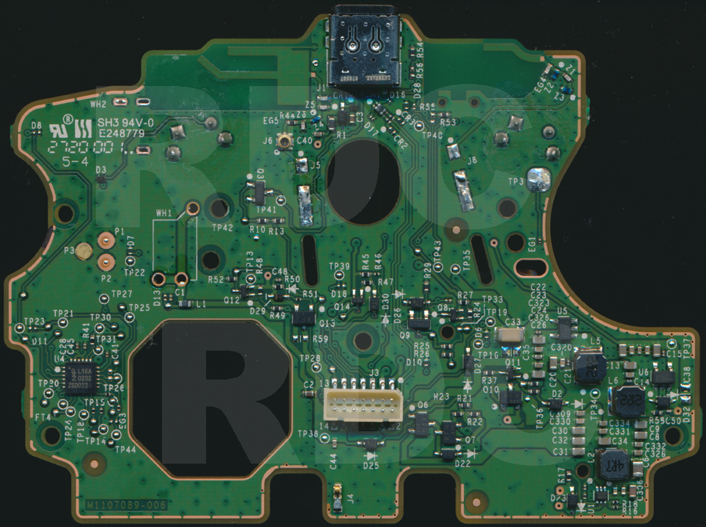

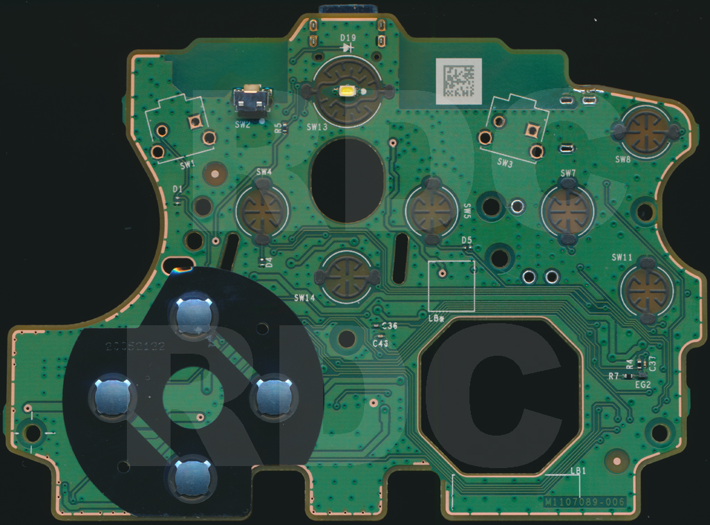

Here we go, again..
The design on this version isn't much different than the 1708 so far, I haven't dug into it yet though. Will update TP spots and yadda yadda yadda when I get the time to poke around with all of that.

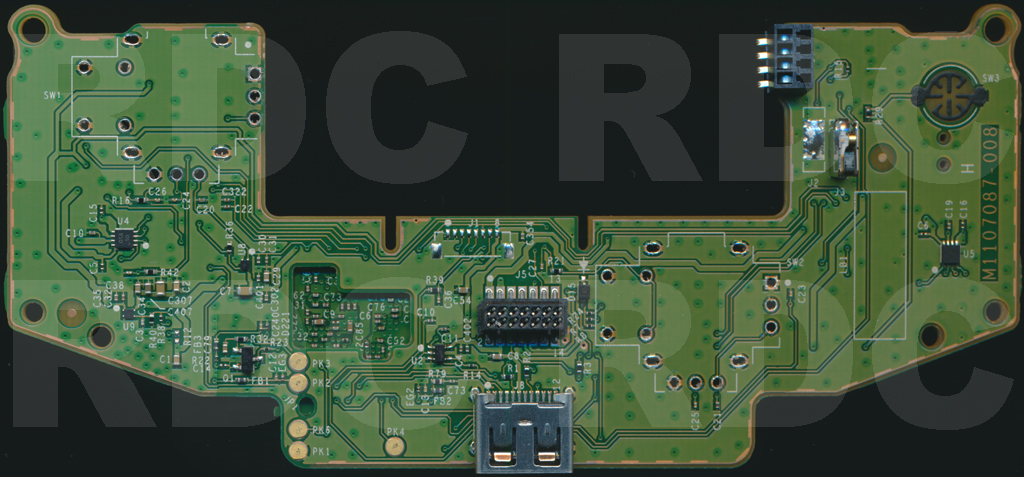

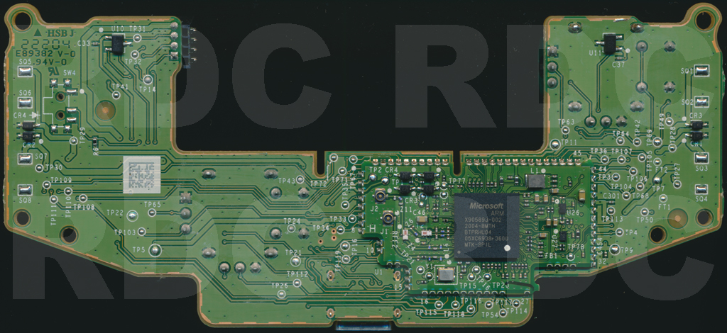

1914 BUTTON/POWER BOARD TOP
1914 BUTTON/POWER BOARD BOTTOM
1914 MCU BOARD TOP
1914 MCU BOARD BOTTOM

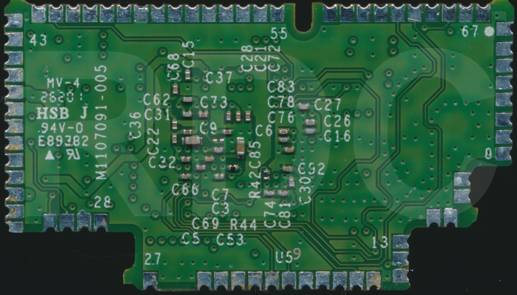

1914 SOC BOARD TOP
1914 SOC BOARD BOTTOM
J3/J5 Connector Pinout
1 - 3.6v
2 - GU (thru D27) Only Guide will work if J3/J5 pin 2 is used for new/alternate Guide button and the controller will not turn on. Use TP43 for a proper duplicate Guide button.
3 - 3v/B+
4 - 3.3v
5 - SCL
6 - LED Control
7 - SDA
8 - D+
9 - ~RESET
10 - D-
11 -
12 - VBUS
13 -
14 - GND
TEST POINTS on BUTTON/POWER Board (some)
TP13 - 5v USB
TP14 - DR
TP15 - DL
TP16 - DU
TP18 - SY
TP19 - LB
TP20 - RB
TP21 - A
TP22 - X
TP23 - Y
TP24 - MN
TP25 - VW
TP26 - U4p16
TP27 - CC1 (thru R55*) CC2 (thru R56*) *not installed
TP28 - LED Control
TP30 - SDA (U4)
TP31 - SCL (U4)
TP34 - 3v/B+
TP35 - 3.3v
TP36 - 3.6v (Rumble V+)
TP37 - 3.6v
TP38 - 5vA USB (after Q13)
TP39 - SH (Share)
TP40 - LED (Anode, after R5)
TP41 - LED (Cathode)
TP42 - LED Control (at Base/Gate of Q3)
TP43 - GU
TP44 - DD
TEST POINTS on MCU Board (some)
FT1 - GND
FT2 - GND
TP5 - VBUS
TP7 - 3.6v (Rumble V+)
TP9 - 3.3v
TP21 - GND
TP22 - GND
TP24 - GND
TP26 - GND
TP27 - LT MOTOR+
TP28 - HEAVY MOTOR+
TP29 - RT MOTOR+
TP30 - LIGHT MOTOR+
TP31 - SDA2
TP32 - SCL2
TP33 - SDA
TP34 - SCL
TP35 - ~RESET
TP36 - AN+ Enable
TP41 - B (thru R29, 100ohm)
TP42 - LSC (thru R16, 33ohm)
TP43 - RSC (thru R21, 33ohm)
TP49 - TRG+ 3.2v, 125Hz, 17% Duty (Hall Sensor VCC)
TP50 - TRG+
TP54 - MIC
TP63 - LSY
TP64 - LSX
TP65 - RSY
TP67 - RT
TP68 - LT
TP103 - AN+
TP104, TP105, TP106 & TP107 - HEAVY MOTOR & LT MOTOR CONTROL
TP108, TP109, TP110 & TP111 - LIGHT MOTOR & RT MOTOR CONTROL
TP112 - RSX
My Schematic* of the Button/Power Board - https://www.acidmods.com/RDC/XB1/Schematics/XB1%201914%20TOP%20BOARD.pdf
My Schematic* of the MCU Board - https://www.acidmods.com/RDC/XB1/Schematics/XB1_1914_BOTTOM_BOARD_SOME_VALUES.pdf
My Schematic* of the SOC Board - https://www.acidmods.com/RDC/XB1/Schematics/XB1_1914_SOC_SOME_VALUES.pdf
SOC Board Designators TOP - https://www.acidmods.com/RDC/XBX/1914/1914_SOC_TOP_DESIGNATORS.jpg
                                        BOTTOM -
https://www.acidmods.com/RDC/XBX/1914/1914_SOC_BOTTOM_DESIGNATORS.jpg
SOC Board Pinout - https://www.acidmods.com/RDC/XBX/1914_SOC.txt
* Information will be updated when/if I get them scoped and/or figured out. NOTE: The MCU Board values are not currently in the schematic. The thing seems to be pretty similar to the 1708 and most of those values should match up.

Hey RDC, can I please ask u to double check the test point for left trigger (LT)? U have it as TP 104 on the mcu board. I just did button duplication on a 1914 board set and everything works great except LT. I just get nothing from it on the accessory test screen.
Solder looks good and I double checked a bunch of other things. Just hoped it's something I am missing. Ty in advance.
Wireless Arcade Controller Guy
  • Posts: 2640
Re: XBX/XBS Controller PCB Scans, Traces and Info - 1914
« Reply #3 on: February 12, 2021, 05:44:18 PM »
It's the TP spot under where TP104 is marked. Which is probably really TP68, given that RT is TP67, so that will be changed. Use the spot to the left of TP68 for LT.
Offline beardawg252002
  • Posts: 45
  • Yep
« Reply #4 on: February 12, 2021, 05:50:20 PM »
Cool, ty. I kinda thought it might be like that cause the test points are kinda wonky in that area. And the numbering seemed weird for LT.
Resoldering after dinner and I will confirm it works. Thanks for the fast response.

Also, a weird question about a possible test point or solder spot on the 1914 where I could run a line to power a guide button duplication led?
Background info: this for my new 1914 arcade controller and I am considering an idea to finish off the controller by using functional artwork, in a way. I am going to use the gutted shell of the x/s controller to incorporate my usb c extension and expansion port extension cables back into the empty shell, then mounted on the exterior of the arcade controller. Also, I would love to finally incorporate a Xbox guide led duplication into this shell. So, when I power on the arcade controller, the xbox controller shell on the outside would have a functional guide button light. This could either be just a solid light, indicating controller is just on/off. Or, depending on complexity, a true guide button led duplication with flashing indicators and all (sync flash and such).
Thanks for any ideas. I know u haven't dug into this board set as much, but since it's pretty much like the 1708, I thought you might have some ideas.
  • Posts: 2640
« Reply #7 on: February 14, 2021, 12:22:14 PM »
Use TP41 on the Button/Power Board for the Cathode side of your new LED. Anode side of the LED will go to the correct value Resistor for your new LED, then to TP37.
« Last Edit: February 14, 2021, 12:30:07 PM by RDC »
  • Posts: 45
  • Yep
« Reply #8 on: February 14, 2021, 12:36:45 PM »
Thanks! Doesn't sound too bad. Would really finish off the controller to replicate the guide led.
So, just to make sure I understand, from the anode side of new led I will add a resistor inline of the same value as the new led before going from the resistor to tp37?
Lastly, I don't know much about what led to use. Any suggestions/links for a simple led I can clear epoxy into an empty guide button shell? Or, I do have a couple old controller board sets on hand. 360 set and my test 1708 set. I could maybe scavenge from that?
  • Posts: 2640
« Reply #9 on: February 14, 2021, 12:57:19 PM »
The Resistor you install will need to be rated for whatever current the new LED needs.
Just about any LED will work, as long as it can be driven by 3.6v or less, as the TP37 is a 3.6v source.
If the LED is rated at 3.3v and 10mA, then the Resistor would be around 30ohm in value.
If you don't know the LED ratings, then always start with a higher value Resistor and work your way down until it lights up and looks decent, not blinding. Preferable to have a couple of the same type of LED so if you wind up going too low and frying it you can go back.

Guide button led duplication works great!! Thank you for the info. Test pic below. New duplicate blue led kinda hard to see, but its glowing in the solder vice.
Arcade box arrives tomorrow and I am going to put it all together over the weekend.

During the right analog stick replacement, I knocked off C23. Following the trace it goes to the expansion port. Controller is working fine. Can you tell me the value of the capacitor and can I take it from previous models? like the 1537/1708 controllers.
  • Posts: 2640
« Reply #25 on: December 17, 2021, 04:52:41 AM »
That trace is the RSY line, it just runs under the expansion port. C23 is just a decoupling cap on that line, you'll never really notice it missing. It's 10nF, 0201 size, anything 4v or more will work if you want to replace it.

Hello RDC would you happen to know what the device U1 is on the power board. Its the small 6 pin package. The markings are AXMM 131 from what I can make out. Ive had a scout online for the device but cant track it down. Thanks for all your great information.
  • Posts: 2640
« Reply #28 on: December 18, 2021, 04:54:06 PM »
@ atarisoul - Bottom side of the board, jumper wire from the middle lead of that POT to TP64.
@ DarkKnight55 - U1 is an MP1476LGTF
« Last Edit: December 19, 2021, 02:21:49 AM by RDC »
Thanks @RDC i have got the left thumbstick working....THANKS
However, I cannot get the L3 button to work. I have tested continuity and the 2 pins near the gnd board edge are OK, when I test the inner pins with the gnd pins there's no connection, when button pressed I get a connection. Thats what I expected as the button completes the circuit.
I have tried to find a test point but I can't work it out
Thanks in advance
