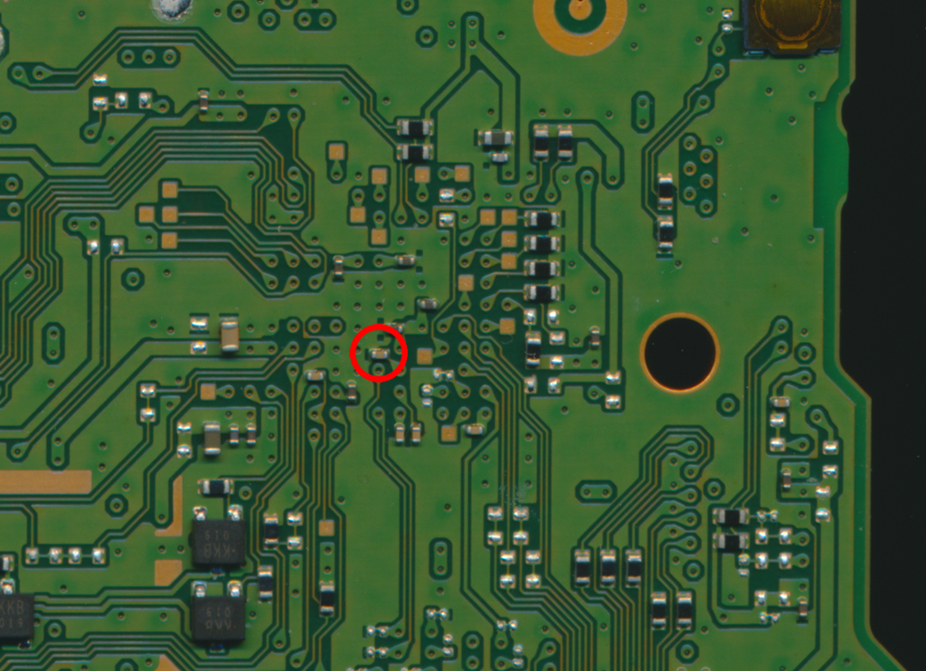

Hello, I have a similar problem. r1 remains pressed all the time. can you help me? (bord BDM020)
@ viewrush - If you mean the R2 is always pressed, then try removing this Capacitor first (bottom side of board) and retest.

  • Posts: 2640
Re: DualSense 5 Controller PCB Scans
« Reply #302 on: April 09, 2024, 06:26:56 AM »
Top side of the board.

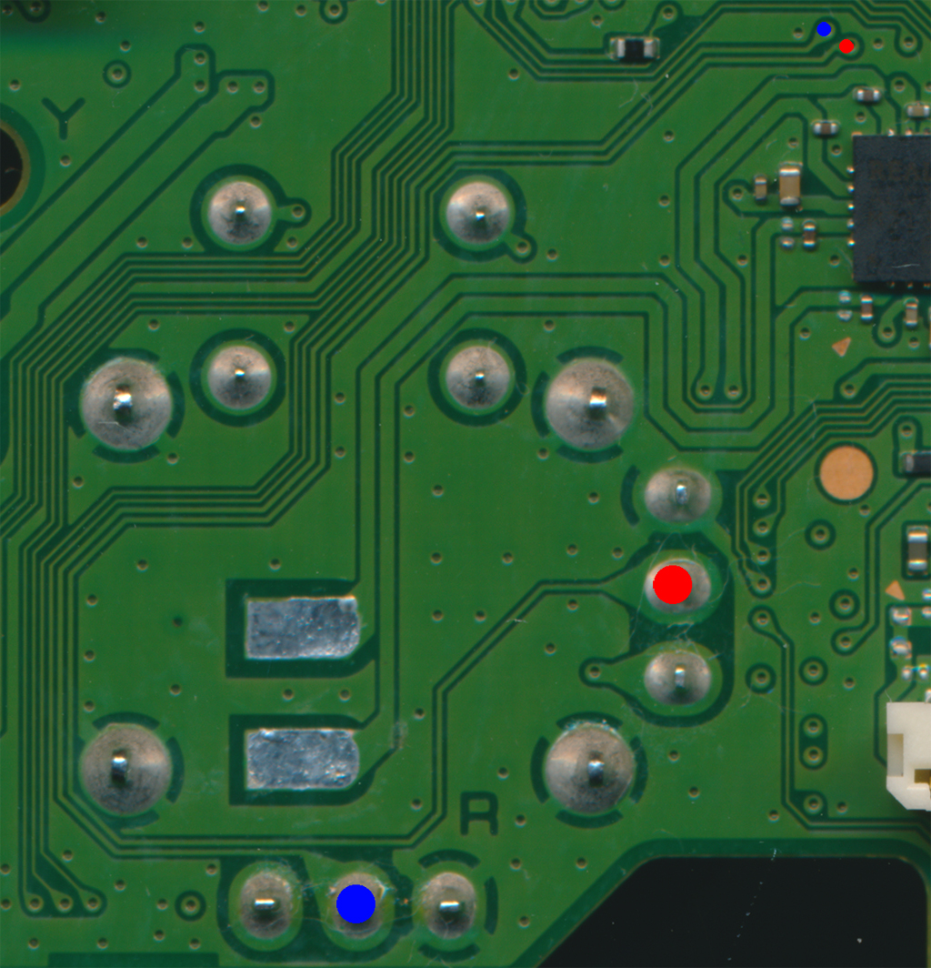

Hey everyone. I have 2 questions for you regarding a BDM-030
Where is a good spot to take the RSY Signal (marked red) , cause the trace is broken right next to one of the stick anchor points. I could try to repair it, but it always end up shorting it to the hole.
And can i just bridge along the blue line to get power for RSX ?  Also, where is the original supply Point of that spot ? From the via next to it i cant find a valid spot

  • Posts: 2640
« Reply #304 on: April 10, 2024, 05:08:09 AM »
That's 3 questions.
1. No easy spots for RSX (red) or RSY (blue). Either have to remove the solder mask on the trace somewhere and solder a wire there to run back to the RSX, or go back to the first via and do the same.
2. Yes
3. From an internal layer, which comes from the PMIC

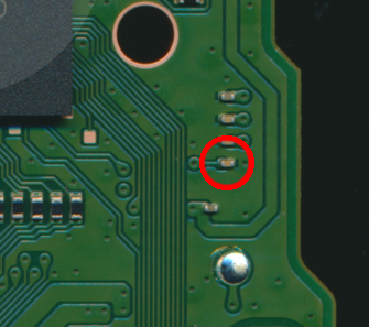

  • Posts: 2640
« Reply #319 on: May 26, 2024, 07:05:22 AM »
@ Kraaz - Top side of the board, remove the marked capacitor and retest.

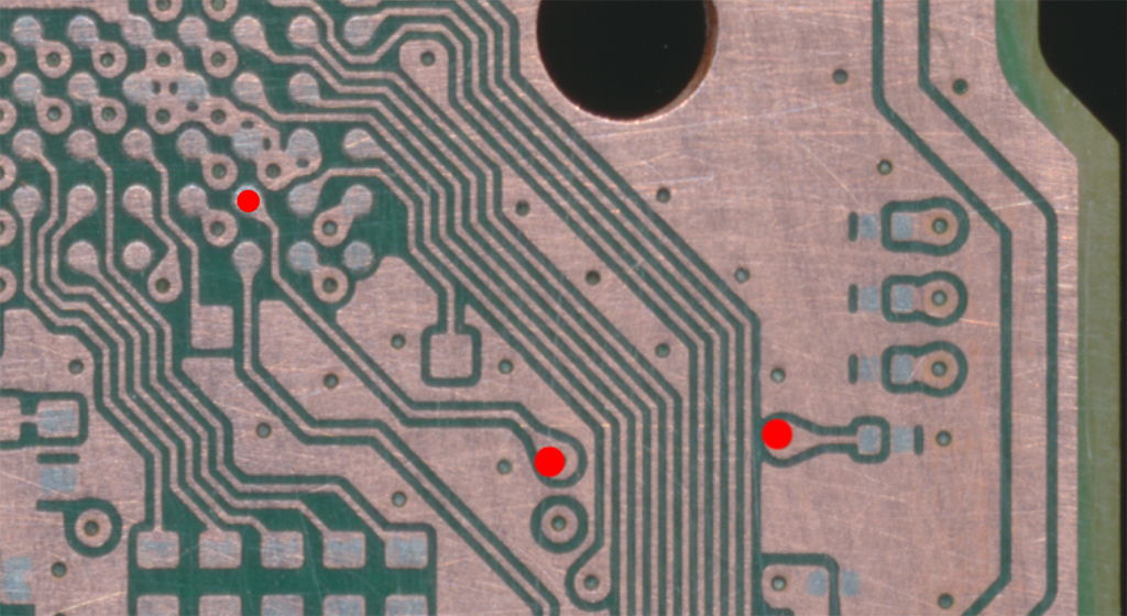

« Reply #324 on: December 06, 2024, 08:10:06 AM »
hi,
i removed this cap, but short on pads still presented, R1 still jamed
where this small leg goes?
  • Posts: 2640
« Reply #325 on: December 06, 2024, 09:03:13 AM »
It's pretty much a straight shot to the MCU.
BDM-020 R1 BUTTON TOP
BDM-020 R1 BUTTON INNER 2
BDM-020 R1 BUTTON BOTTOM
