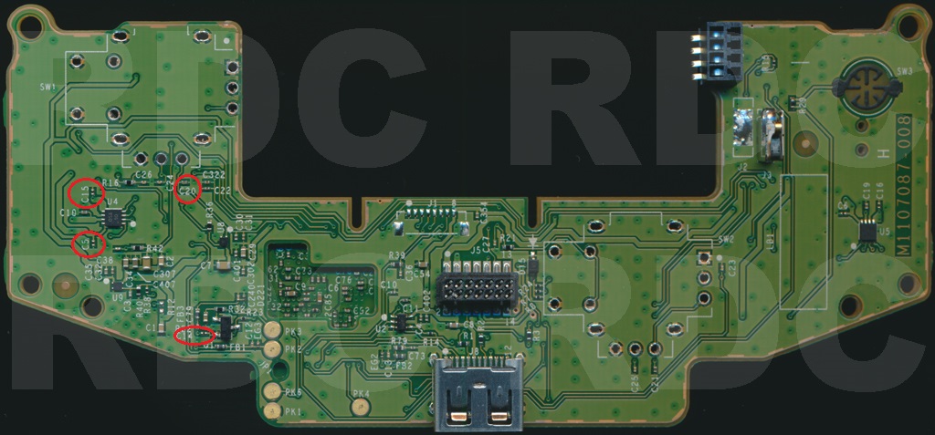

Offline notpoopler
Re: XBX/XBS Controller PCB Scans, Traces and Info - 1914
« Reply #46 on: May 26, 2022, 08:42:55 AM »
Can anyone please tell me what the top left component is outlined in red? (top left of the 4 black components marked with "20" near the antenna connectors) I had a brand new 1914 Series X controller sitting as a spare for 8 months and I finally opened it up today to put a new housing on and start using it and immediately noticed the component in question was snapped off on the left side. The leg of the component itself is broken so I couldn't solder it back in place.
Does anyone have any idea what this part is? And if I should be worried about it? The controller works fine. All buttons and rumble motors work. It's just bugging me because I'm not sure if I should be worried about it or not. Really don't want to replace it if I don't have to because I hate soldering such tiny components. Thanks guys.
The one I outlined is the one that was broken off. The leg on the left was snapped off completely from the component itself. Brand new controller out of the box that came bundled with the series X console. Can't return it because it's been in my closet in the box for 8 months.
« Last Edit: May 26, 2022, 08:58:12 AM by notpoopler »
  • Posts: 2640
« Reply #47 on: May 26, 2022, 12:02:19 PM »
It's one of the 4 steering diodes there for the USB data lines. It will work without it, but if you're going to be plugging up the USB cable to it then it would be best to replace it. No idea what the exact specs are, best to get a replacement from another controller board.
Offline notpoopler
« Reply #48 on: May 26, 2022, 01:00:12 PM »
Oh that's great to hear! So I can still charge it with USB right? It seems to charge when I try. I never use it in wired mode personally so it's not an issue if it's just to do with DATA and not power. Thanks so much for response btw this has been bugging me all day!
edit: The cable I charge with is a power only cable too. It has no data connectivity so I should be fine charging it without replacing that shifting diode right? Really not down to do that job as those antenna connectors get in the way and they're super easy to rip off the board when trying to disconnect them. If it's not going to harm the controller further then I'm content just to leave it as it is. I'm not great with electronics but I'm assuming that if the cable I use to charge doesn't even have data lines then there's not going to be any chance of further damaging it?
« Last Edit: May 27, 2022, 06:26:41 AM by notpoopler »
  • Posts: 2640
« Reply #49 on: May 29, 2022, 08:04:56 PM »
If the USB cable is just 5v and ground then it should be fine.
