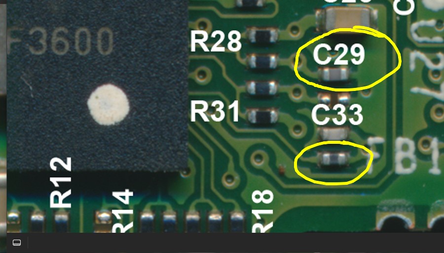

Hello, please tell me the parameters C29 and FB1
  • Posts: 2670
Re: XBX/XBS Controller PCB Scans, Traces and Info - 1914
« Reply #243 on: July 30, 2024, 08:43:10 AM »
No idea on the exact specs, but the FB1 is just a Ferrite Bead, you can jumper wire that one. The C29 is on the SDA line, so it's going to be a low pF value. The 1708 has a 47pF on there.

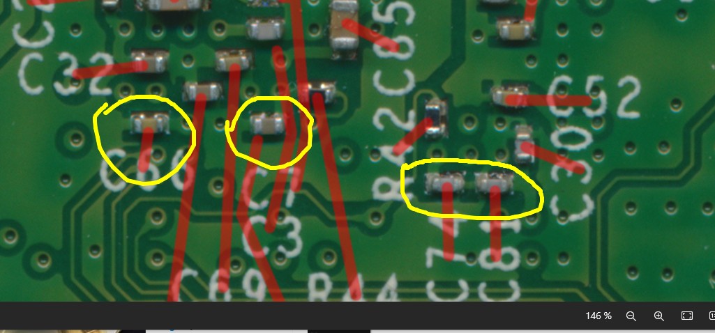

This is the back side of the processor board. Tell me parameters С74 С81 С66 С53
Offline huggies99
  • Posts: 7
« Reply #245 on: August 03, 2024, 03:52:24 PM »
C66 - 100nF
C2 - 100nF
C53 - 1.0uF
С74, C81 - ?? My tester couldn't set their parameter. If I can find out the nominal value, I'll add it.
  • Posts: 2670
« Reply #246 on: August 04, 2024, 09:14:36 AM »
C74 and C81 are decoupling caps on the 3.3v rail, values are not critical, anything from 1nF to 100nF would be fine there.

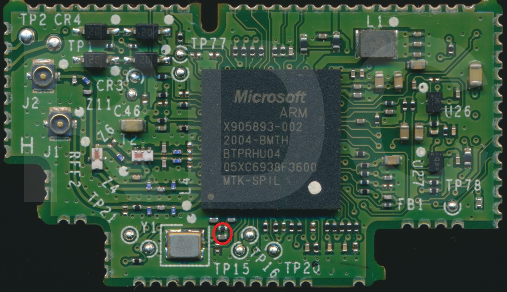

Hello
I broke off C47 from the SOC board. Can you help me what is the value of the capacitor?
