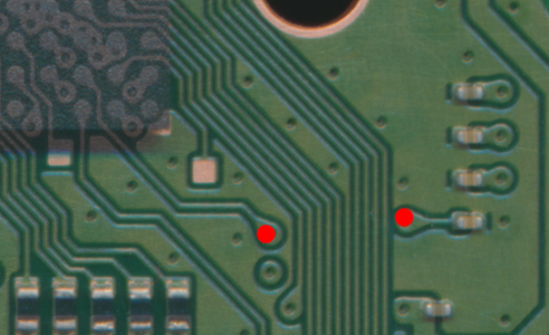

Hello, I have a BDM-020 board where I am missing a part...does anyone know what its value is? or what exactly is it that my R1 button is on?
« Last Edit: March 31, 2025, 11:12:37 PM by Para81szs »

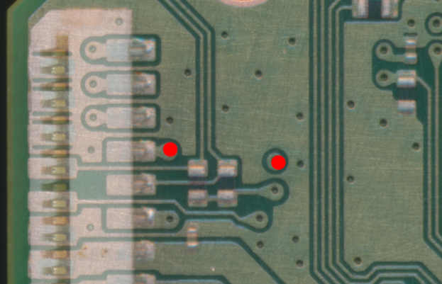

I put a capacitor similar to the rest but it still blocks R1, does anyone know where else I need to check because I can't find a diagram?
  • Posts: 2670
Re: DualSense 5 Controller PCB Scans
« Reply #359 on: April 02, 2025, 03:00:33 PM »
Not much to the R1 trace on that board. Connector, via, cap, short trace on an internal layer, another via then right to the MCU. Either the cap is shorted, the trace is shorted somewhere along the line (under the connector could be a possibility), or the MCU has an issue.
